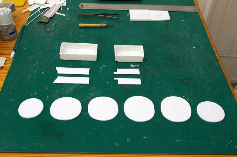

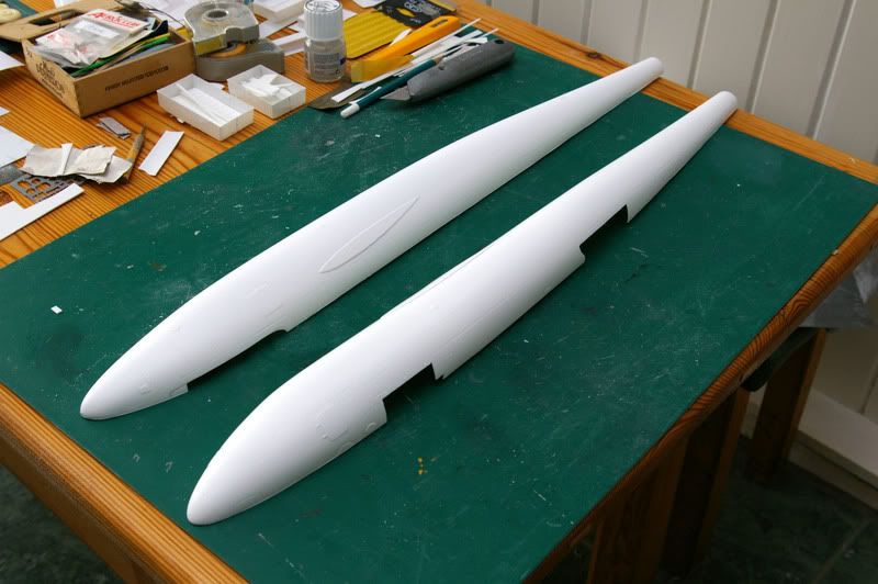

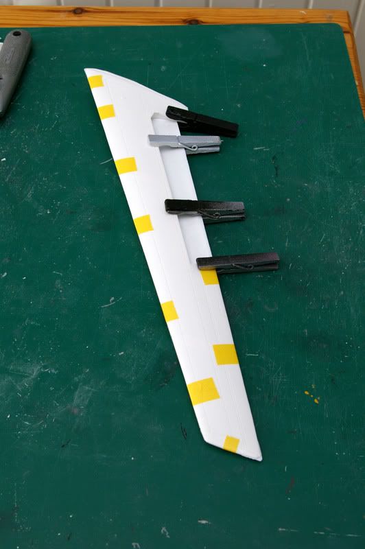

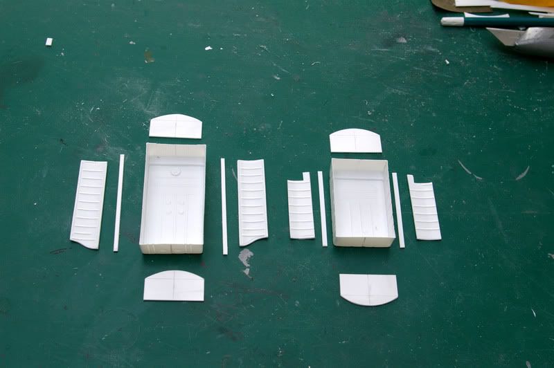

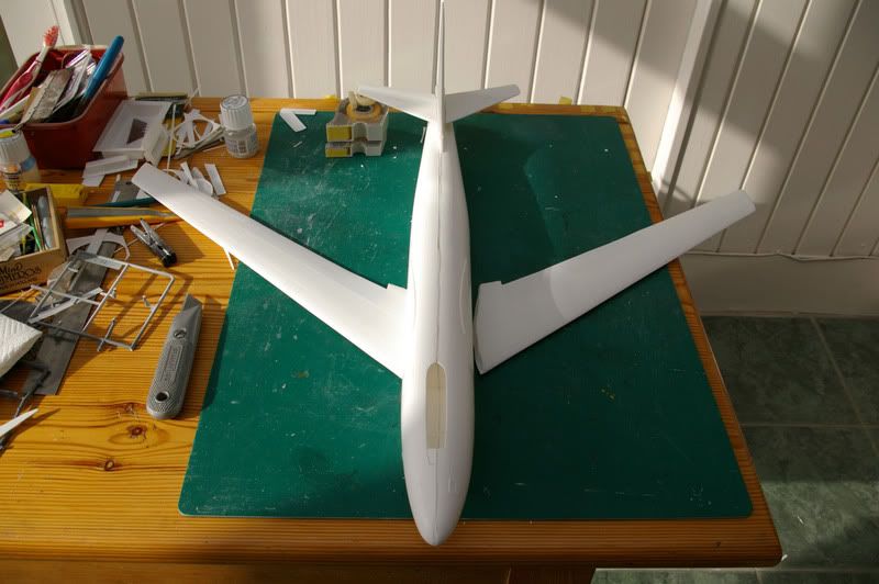

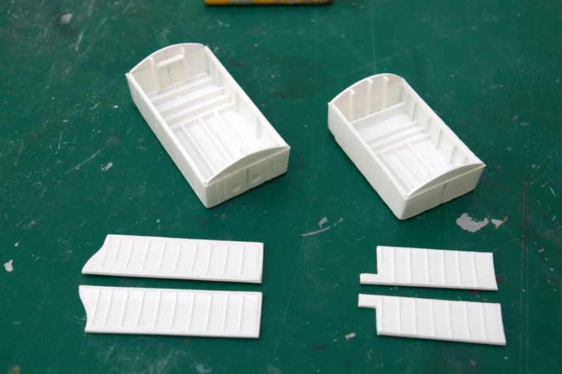

Darius at home Posted February 24, 2007 Author Share Posted February 24, 2007 (edited) After an absence of several months, this beast is back on the bench. I started with the starboard mainwing sanding and re-scribing the vac-form halves before cementing them together. Having committed myself to this with the port wing, I removed the flaps from the lower wing half. The photos I took last year helped to remind me what to do!!! I sanded the fuselage halves and removed the main gear doors and cockpit aperture from each half. Sanger provide vac-formed main gear wells and gear door inner surfaces. The latter were cut from the backing sheet and skinned with thin plastic card. The gearwells were detailed with additional ribbing/stiffeners cut from scrap parts of the vac-form backing. Thats it for today. The next stage is to replicate the flap well detail on the starboard wing. <_< Darius Edited February 24, 2007 by Darius at home Quote Link to post Share on other sites

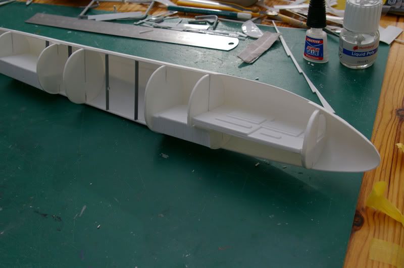

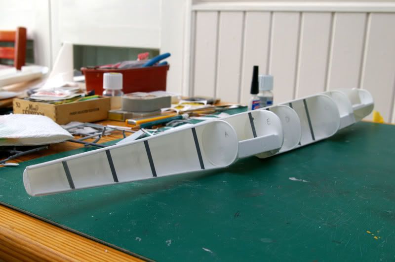

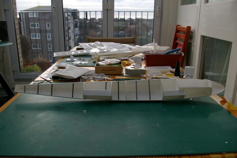

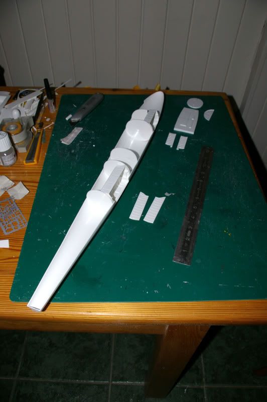

Darius at home Posted February 25, 2007 Author Share Posted February 25, 2007 (edited) After a 7am 16 mile bike ride up into the South Downs and back to the sea, a hot bath and a breakfast of bacon and eggs, it was back to the bench. Sanger provide a set of fuselage bulkheads which are very useful. I swapped bulkheads A and F from their instructed positions as their shapes were better suited to the tail and nose respectively. The bulkheads were super-glued into the port fuselage halves along with the gear wells. I cemented strips of plastic card to the fuleage edges between the bulkheads to serve as attachment points for when I glue the fuselage halves together. Lengths of old kit sprue were cemented between these strips to maintain the fuselage profile between the bulkheads. The cockpit floor is provided as a vac formed piece with some interesting lumps formed within it. I am not sure if these relate to anything in particular as the cockpit seats will sit along the centre line (unlike these lumps) and will be at a higher level than this floor. I will use the kit floor as a platform upon which to scratch build the cockpit. All in all a quite satisfying morning. Darius PS. kaburaya, the model will represent a B-47E with the partial white underbelly scheme. No particular unit selected yet. I am open to suggestions... Edited February 25, 2007 by Darius at home Quote Link to post Share on other sites

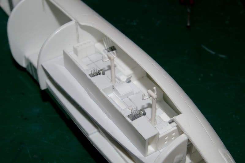

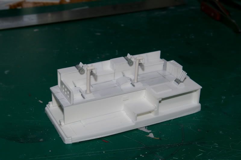

Darius at home Posted February 25, 2007 Author Share Posted February 25, 2007 Made a start on the cockpit today using plastic card and bits of sprue. The seats and instrument panels will be next. :) Darius Quote Link to post Share on other sites
davetur Posted February 25, 2007 Share Posted February 25, 2007 I wish I could be as precise and clean with injected models as you are with vacforms, Darius. Just a silly question: are you sure about only four throttle levers on a 6 engine aeroplane? Regards Davide Quote Link to post Share on other sites
Darius at home Posted February 25, 2007 Author Share Posted February 25, 2007 I wish I could be as precise and clean with injected models as you are with vacforms, Darius.Just a silly question: are you sure about only four throttle levers on a 6 engine aeroplane? Regards Davide Doh, quite right - just about enough space for two more levers on each!!! Darius Quote Link to post Share on other sites
