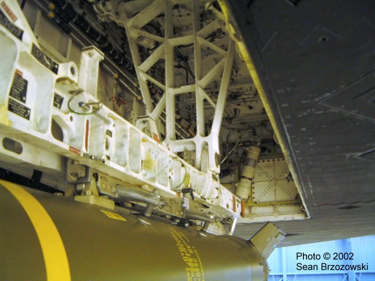

John Wolstenholme Posted June 9, 2018 Author Share Posted June 9, 2018 Hi MFareF’s, Steve and Joel, thanks for your interest and taking the time to post. Speaking of ‘interest’, discovered an error/problem of my making which led me onto something else. With the new ‘double doughnuts thingies’ on the rear wall, the sidewalls will no longer fit as these clash with the door locks – kit or otherwise. As you can see I have stripped everything off the sidewalls and started reforming the door locks, pieces only placed. So the back wall has to be redone. But an interesting thing in the SS Walkaround p15, where part of a caption reads “Air Force restrictions prevent civilians from getting closer than 20 ft”. Therefore, presumably all photos in print or on the internet of the weapons bays are of museum YF-117 examples? Now if you look at the photo of the stbd bay on p37 of SS F-117A you see the ‘twin doughnuts’, but looking at these port photos on ARC http://www.arcair.com/awa01/401-500/awa422-F-117-Brzozowski/17.jpg http://www.arcair.com/awa01/401-500/awa422-F-117-Brzozowski/18.jpg there is no sign of them. So a question arises in my mind, were these a std fit on squadron acft, or are these camera housings for weapons release trials only. Hmm, I feel a kit-kat coming on. Quote Link to post Share on other sites
John Wolstenholme Posted June 14, 2018 Author Share Posted June 14, 2018 The kit-kat had to wait, as I felt in the zone. 136 pieces of plastic, resin and Cu wire later, the weapons bay door locks are finished to the walls. The more I look at the photo of the stbd weapons bay, p37 of the F-117A Walkaround, it seems to me the twin cylindrical objects are not on the back wall, but forward. Also, there seems to be a slight reflection from a ‘flash’, as if the front element of a camera. But then I may be delusional. Quote Link to post Share on other sites
