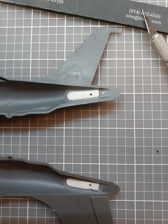

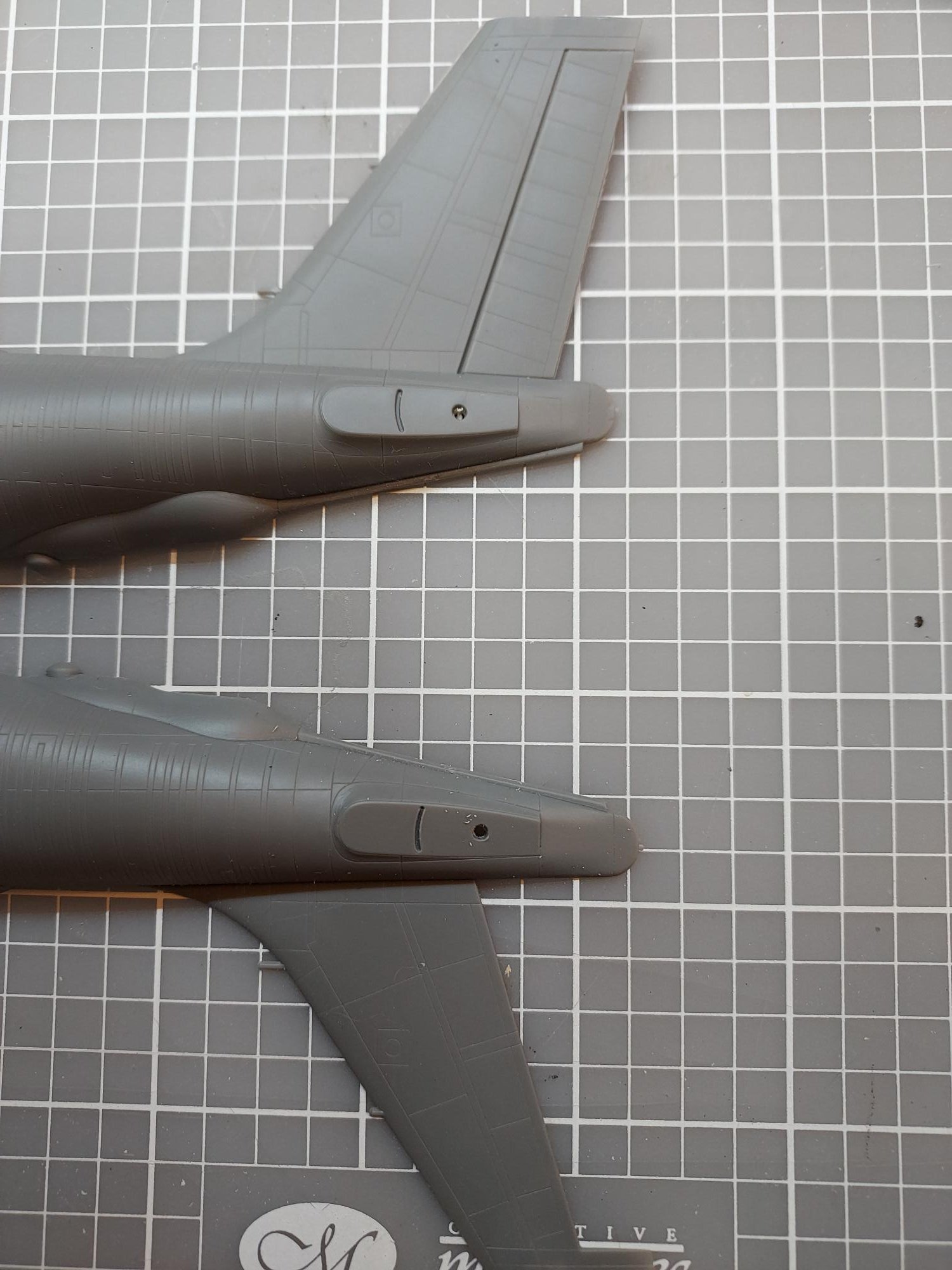

Dutch Posted July 1, 2022 Share Posted July 1, 2022 (edited) Okay, I am now starting my Roden 1/144 #349 RC-135V/W RIVET JOINT build thread. I thought that the "In Progress Pics" sub-forum would be a better place for this thread. To see my initial impressions, see my thread in the Jet Modeling sub-forum. The first thing to fix is to remove the ugly hump for the horizontal stabilizer mounting area. I made mention of this in my initial impressions. It appears to be bigger in those pictures than it really is upon closer inspection. I thought to carefully cut the flat area of the mound away, then grind down the remaining sides, widen the hole to accept the flat area, place a backing plate inside the fuselage and then fit the flat area into the hole, putty, sand and rescribe to taste. After trimming some .04 platicard to act as a backing plate. I am now reconsidering. I may just drill a hole to accept the horiz stab and grind away the existing plastic to get down to the .04 plasticard backing. 1. First thing I noticed on removing the fuselage sides from the sprues was a little bit of flash on the inside of the cockpit combing. It proved rather stubborn to just flapping back and forth to remove, so I carefully trimmed it with an X-acto knife, then sanded the edges flush. 2. The other thing I noticed is that the stbd tail trailing edge is a little short. I am not sure if this is intentional, but it would then leave a very sharp trailing edge for the top of the vertical stabilizer, so maybe it is okay. 3. The inside edges of the tail halves. The horizontal stab mounting area is not that deep and I think I can just fill the area with .04 plasticard. 4. The Roden horiz stab mounting area (bottom) from the outside, in comparison with the similar area from the Minicraft EC-135C kit (top). 5. Bad photo. I was holding the fuselage with my right hand, holding my cell phone camera with my left hand, trying to use my nose to push the shutter button. LOL! The mound is not so tall as previously thought. Also, it seems to be angled so as to provide dihedral to the stabs. I will make sure to include a slight angle of the finished mounting area for the dihedral. 6. I always overcut my plasticard, then trim and sand to shape with a rough/medium sanding stick. 7. .04 plasticard backing plates trimmed and super-glued in place. Edited August 27 by Dutch Quote Link to post Share on other sites

Dutch Posted July 1, 2022 Author Share Posted July 1, 2022 (edited) A few more photos. But I have to take a quick halt. I think I just broke my foot! I took the fuselage halves out to my workshop in the garage and used a 1/16" drill bit in my drill press to drill the stabilizer hole through the white plasticard so that the horiz stab will be in the correct position. Then I broke my foot. Wife informs me that the recommended treatment = RICE: Rest, Ibuprofin or Ice, Compress, Elevate. (I thought of: Rest, Imbibe adult beverage, Chill by poolside, & Eat!) Next up, (if I can find the photo I just took), is the clear part put in place on the cockpit. The area forward of the windscreen seems to be a little flat. Edited August 27 by Dutch Quote Link to post Share on other sites

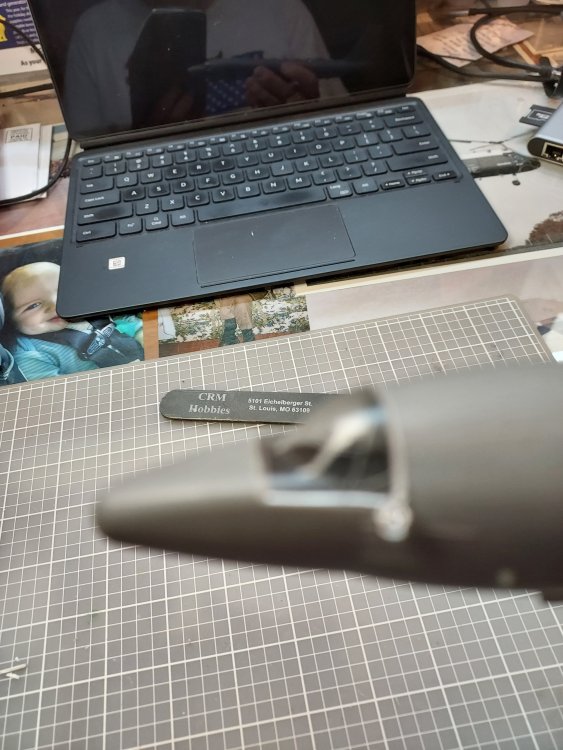

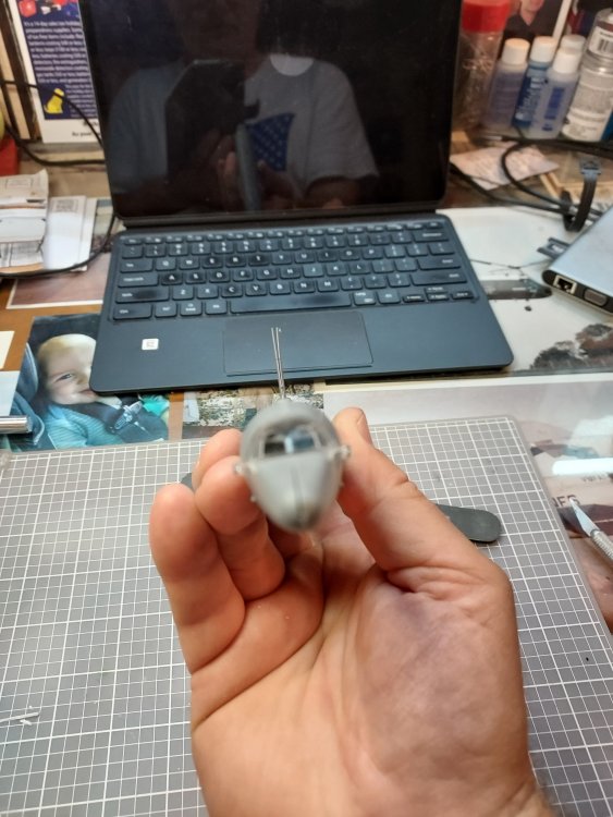

Dutch Posted July 2, 2022 Author Share Posted July 2, 2022 (edited) Okay, I switched to my cell phone to post the nose & cockpit profile photos. I must say, I was skeptical at first, but I do like the clear cockpit profile when I looked at it from the side. The area ahead of the windscreen looks a little too flat, but once assembled, it may be alright also. Again, my apologies for the lack of photo quality or focus, as I was juggling the fuselage in one hand, the cell phone in the other and trying to get it focused on the cockpit, then snap the shutter before it focused elsewhere. 🤪 1. First photo looks good. Even in focus. 2. Head on view. Slightly out of focus, but still looks good. Hmm, must have bruised my hand when I fell down at the time I broke my foot. 3. Again, out of focus, but the area ahead of the windscreen looks flat. 4. Okay, I am a better model builder than photographer, really. I may retake these photos. Edited July 2, 2022 by Dutch Quote Link to post Share on other sites
