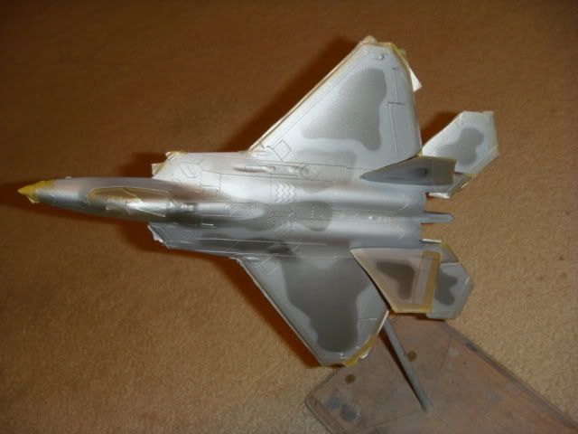

mrvark Posted March 23, 2008 Share Posted March 23, 2008 It is, in general, a very nice kit. I'm nearly done with the test shot that I received a couple of months ago. There are a few minor problems: It would have been nice if the top and bottom of control surfaces had been molded on the top fuselage half. The trailing edges are so thin that care needs to be taken when removing glue seams in that area.. The exhaust petals have one scribed line on the outboard side. There should be at least two, if not three. When you start looking at photos of that area (look no further than the cover shot of the Aerofax book) you'll see what I mean. In the end, I couldn't figure out exactly what was going on and made masks for the missing panel that is there all the time. The other bone-shaped panel MAY be something that is only visible when the petals are moved to certain positions. There is a missing "notch" on the top of the fuselage right above where the inboard wall of the intake meets the top of the fuselage (check photos and you'll see it. A very minor omission that can be easily fixed with a couple of swipes of a file. The most annoying problem are the wingtip lights. It would have been nice if they had been molded in clear (and been more streamlined). The sink marks on the weapon bay doors are no big deal--a coat of Mr. Surfacer takes care of them. BTW, I don't know if its mentioned in the instructions or not, but the nose pitot tubes are parallel to the ground, not perpendicular to the fuselage. The masking and painting are the most challenging part of the kit. The decal sheet RoG has put together will be a HUGE help with that. A tip on masking the wing edges. Start with the wingtips. The outboard edge comes right up to the scribed outline of the wingtip lights; the trailing corner reaches the aft point of the wingtip light. That will give you the correct width. Tamiya 5mm tape works great for this. The biggest omission is that there is no scribed line for the very complicated radome. To fix this and the lack of scribing on the exhaust petals, I've come up with a couple of templates. Just print them out, lay a piece of Tamiya tape across them, and cut them out. I'm sure Eduard will come out with something eventually, but these will get you close. I'm using the technique developed by Mark Bilas to paint it. Looks great, but I was so scared about painting silver that I cleaned my study and did my taxes before taking the plunge! In the end, the actual painting only took about an hour, start to finish! Quote Link to post Share on other sites
Andre Posted March 23, 2008 Share Posted March 23, 2008 I'm using the technique developed by Mark Bilas to paint it. Looks extremely good. Would you happen to have a link to that technique? I've got the Revell kit, but will first do a test run with the Italeri one I have in the stash (with some surplus Revell parts - the new kit will be all buttoned up) and an article would be a great help. Cheers, Andre Quote Link to post Share on other sites
mrvark Posted March 23, 2008 Share Posted March 23, 2008 Looks extremely good. Would you happen to have a link to that technique? I've got the Revell kit, but will first do a test run with the Italeri one I have in the stash (with some surplus Revell parts - the new kit will be all buttoned up) and an article would be a great help. Cheers, Andre Try this: F-22 Painting Technique Quote Link to post Share on other sites
Andre Posted March 23, 2008 Share Posted March 23, 2008 Try this:F-22 Painting Technique Thanks, extremely helpful! I just hope to get a good match with the Revell decals.... Cheers, Andre Quote Link to post Share on other sites
