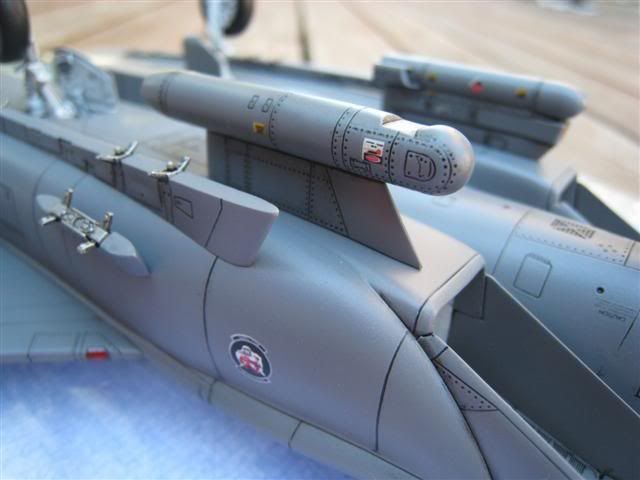

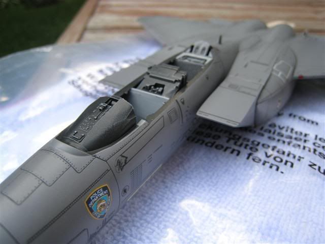

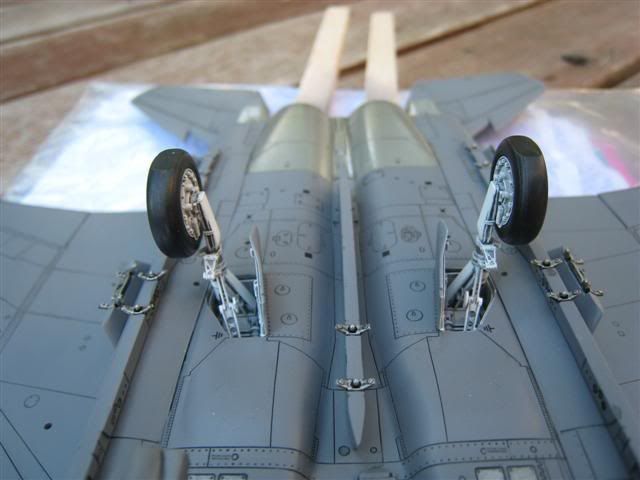

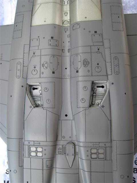

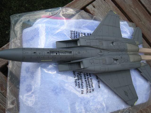

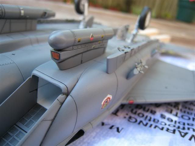

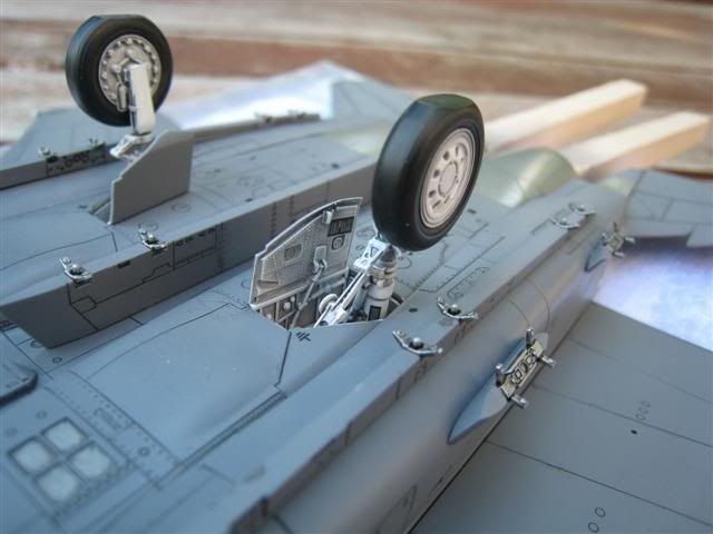

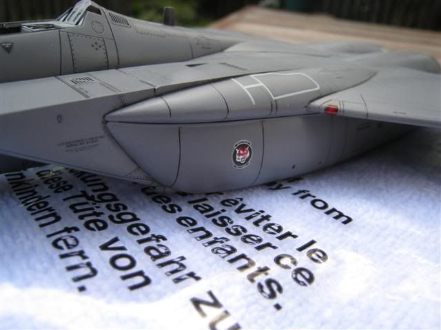

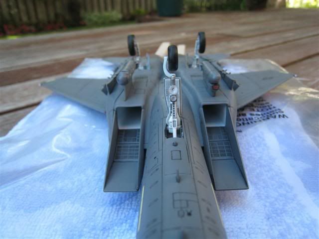

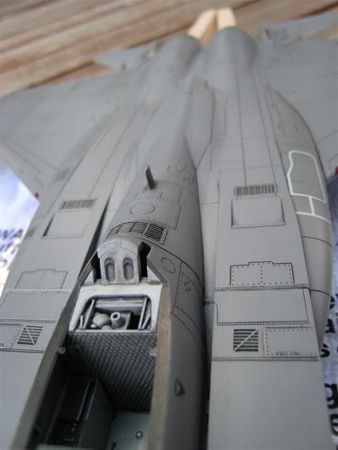

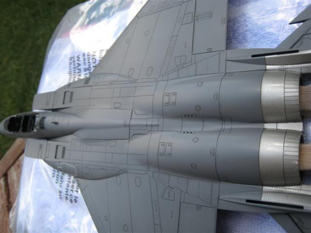

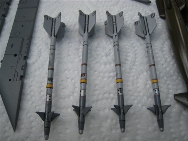

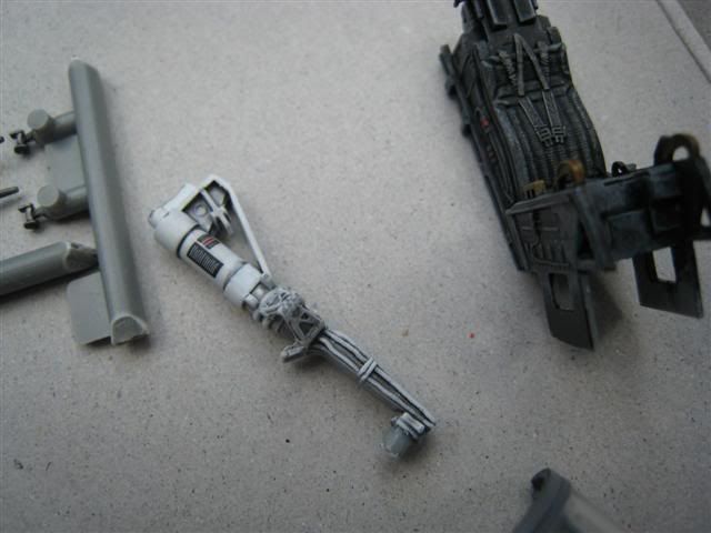

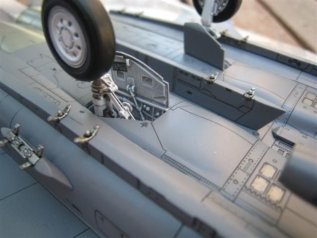

lgl007 Posted July 2, 2007 Share Posted July 2, 2007 Hi everyone, Well, here's an update on my build... I'm very pleased with it as this is my first aircraft model in almost 20 years ;-) If you want to see all the photos of the build check it out in my photobucket account: http://s98.photobucket.com/albums/l249/lgl...Revell%20F-15E/ Let me know what you all think and thanks for looking :-) -Greg Quote Link to post Share on other sites

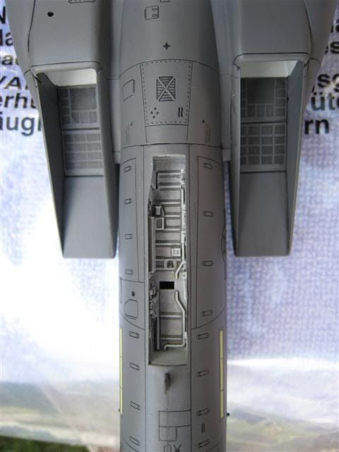

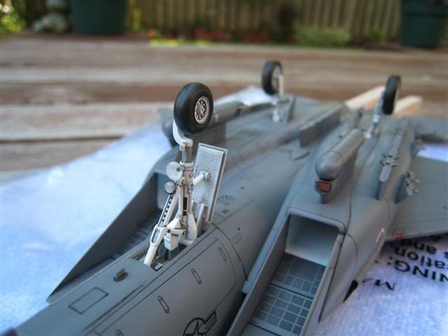

lgl007 Posted July 2, 2007 Author Share Posted July 2, 2007 Here's some more... Quote Link to post Share on other sites

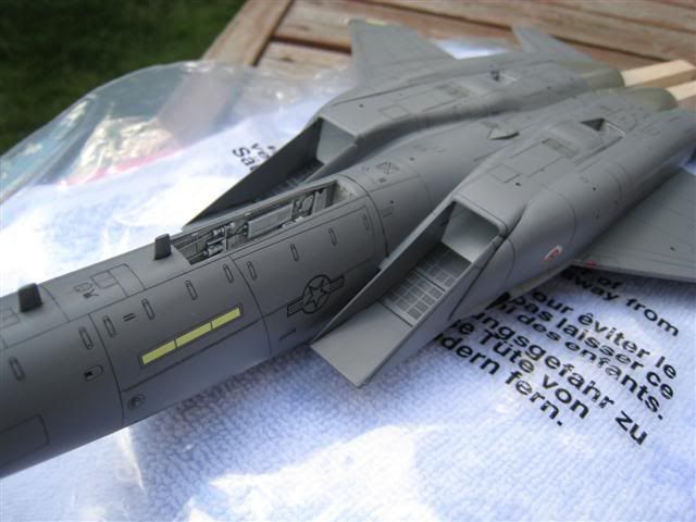

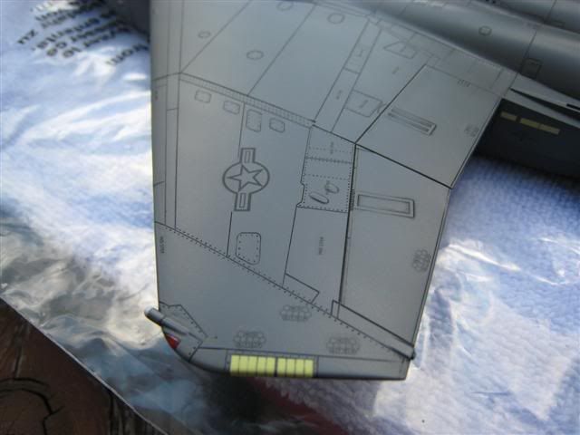

lgl007 Posted July 2, 2007 Author Share Posted July 2, 2007 ... and some more :-) Quote Link to post Share on other sites

dreammh Posted July 2, 2007 Share Posted July 2, 2007 Wow. Very neat build! How did you make the panel lines so pronounced? Quote Link to post Share on other sites

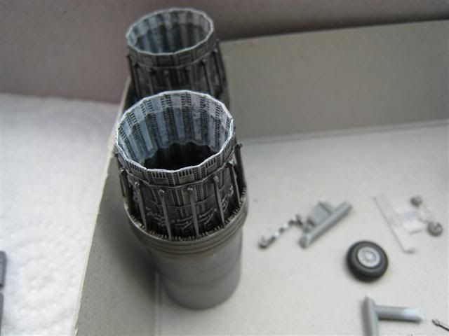

flogger23 Posted July 2, 2007 Share Posted July 2, 2007 Well done, especialy the exhaust pipes Quote Link to post Share on other sites

Su-34 Posted July 2, 2007 Share Posted July 2, 2007 I love it! Everything looks great, especially the panel lines! Quote Link to post Share on other sites
dragan_mig31 Posted July 2, 2007 Share Posted July 2, 2007 this is very nice since i am about to paint my f-15 E can u tell me what colour did u used for the overall? Quote Link to post Share on other sites
lgl007 Posted July 2, 2007 Author Share Posted July 2, 2007 Hi everyone, Thanks for the great comments... Dreammh: Here's the process I use for the build... 1) I airbrushed on the base color(s) (I used Gunze Sangyo Acrylics - Acqueous Hobby Color)… · I put in about 5% Tamiya Acrylic Paint Thinner to each batch of Gunze Acrylics I airbrush on. 2) I airbrush on clear gloss (again Gunze Acrylic) - not too heavy because I don't want to seal too many of the panel lines with too much paint; 3) I use Citadel acrylics and mix my own panel wash (approx 80% water 18% black Citadel paint and 2% dishwashing detergent - I kinda eye this bit and add more paint if the panel lines are not coming up as vividly as I like)… · I don't apply the wash too liberally in fact I try to get it in the panel lines as much as possible... let dry for 2-10 minutes then I rub of excess with paper towel (Citadel paints dry very quickly)... apply a bit of moisture to stubborn spots on the paper towel... you may need to re-apply wash if you rub it out of panel lines. The clear gloss coat ensures that the excess panel wash comes off quite nicely; 4) Apply another thin coat of clear gloss to seal panel lines in preparation for decaling; 5) Apply decals with Micro Set and Micro Sol; 6) Apply matt coat (Gunze acrylics again)... actually I applied 3-4 coats. But I let the model dry at least 24-48 hours between any coats… again I was going for the painted on look of the decals. I used a slightly different technique for the landing gear to get a different effect. The landing gear was just aibrushed matt white (Gunze) then panel washed (Citadel - as above) into crevices, then dry brushed with Citadel white... allowing maximum control of the amount of darkness coming through the white. The effect is quite good for landing gear on aircraft that are kept immaculately clean… the resultant shading looks grey... more like layers of dust as opposed to dirt and grime. dragan_mig31: The color I used for the body was Acqueous Hobby Color H305 Gray FS36118 Best, -Greg Quote Link to post Share on other sites
strikeeagle801 Posted July 2, 2007 Share Posted July 2, 2007 Greg Amazing my friend. Absolutely stunning. Thank you so much for the tip on the panel wash. I am forever in your debt. Can not wait to see the whole thing finished. Keep up the good work! Aaron Quote Link to post Share on other sites

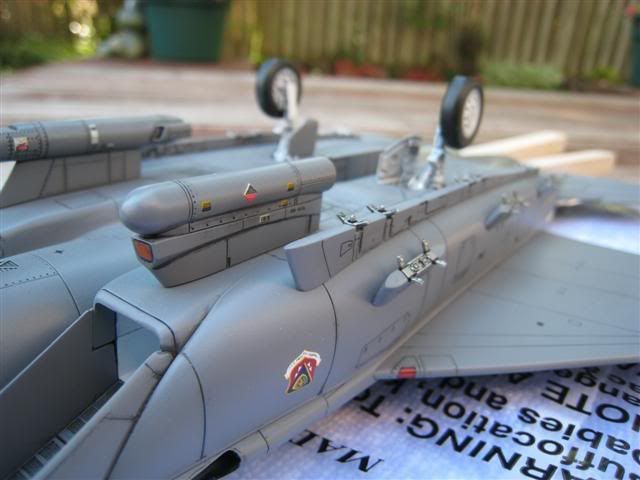

96Delta Posted July 4, 2007 Share Posted July 4, 2007 (edited) Looks awesome Greg! Will be printed and added to my coveted "tips and techniques" binder when you are finished. :) Since the airframe looks so good, how did you tackle the instruments? David Edited July 4, 2007 by 96Delta Quote Link to post Share on other sites

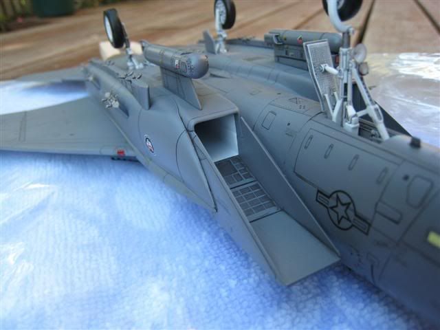

Ollie 17 Posted March 19, 2011 Share Posted March 19, 2011 You did a great job but dude you have your white in your intakes too much. 6 scale feet in the color of the outside of the aircraft is on the insides other wise I will give you a 10 for sure. Quote Link to post Share on other sites
