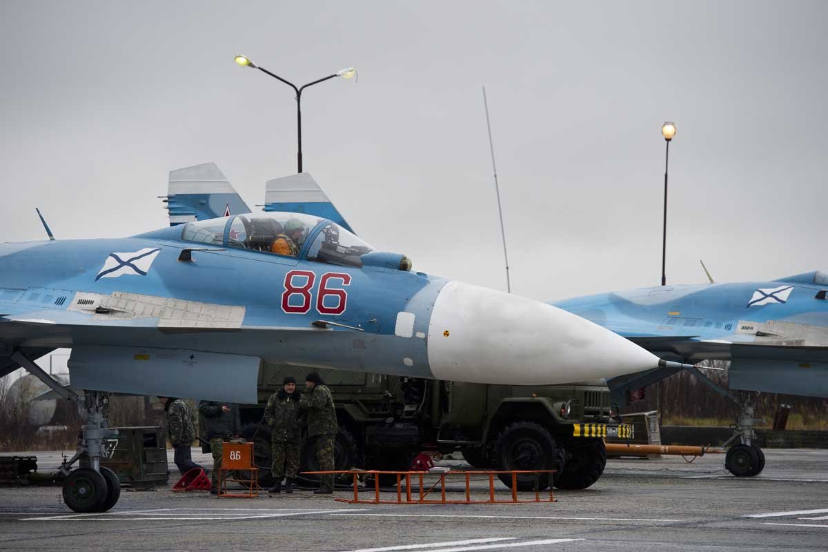

The MRP colors are representations of the current camo colors used on Su-33s. There are both hard and soft edge versions of the scheme with the new colors. Perhaps you are thinking of the earlier colors worn by the Su-33. Here is a photo showing the older camo on the aircraft in the foreground and the newer camo in the background.
658
16 minutes ago, Matt Walker said:
Ok, I had not remembered "quite" correctly. Getting old....
Join the club 😉
