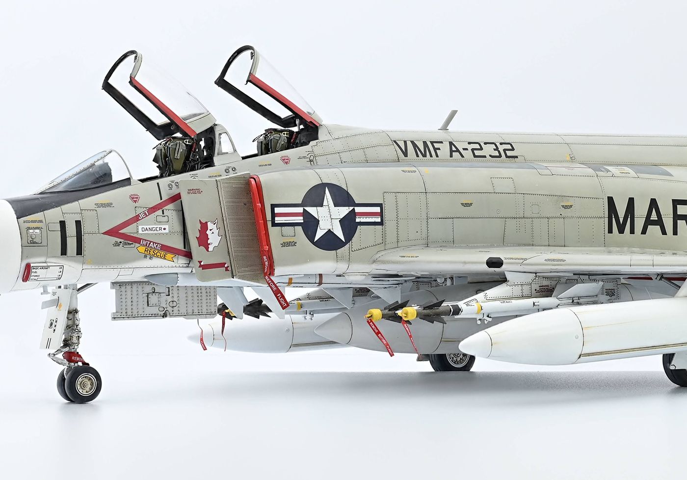

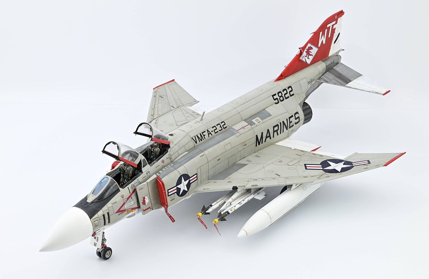

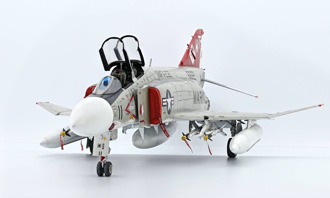

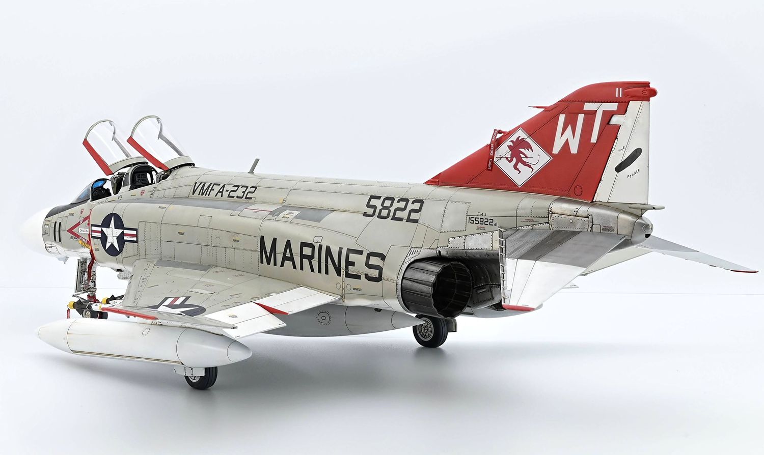

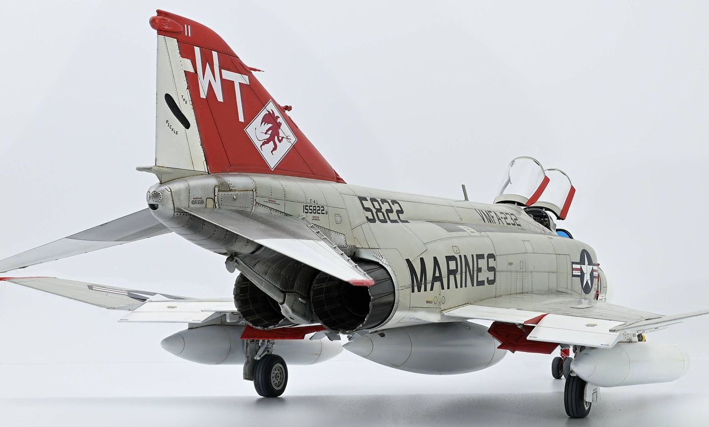

12 hours ago, aircommando130 said:
A little clean for a Marine bird...but I like it!
Gorgeous work!  The paint finish is just flawless and all the little details like the intake covers and RBF tags make it really stand out!  Superb model 👍🏻
Steve
Absolutely flawless. Every now and again I see a model on this forum that just blows me away. This is one of those...
Looks awesome. I especially love all the close-ups. Your photography is beautiful as well. I wish I could take pics like that. Can you share your camera and lighting setup?

Another reason for this forum to have a big ❤️ button on their posts. Beautiful build and photography. Love the way those flags look as if they are blowing in the wind.
Yes, I've tried to get that feeling thanks

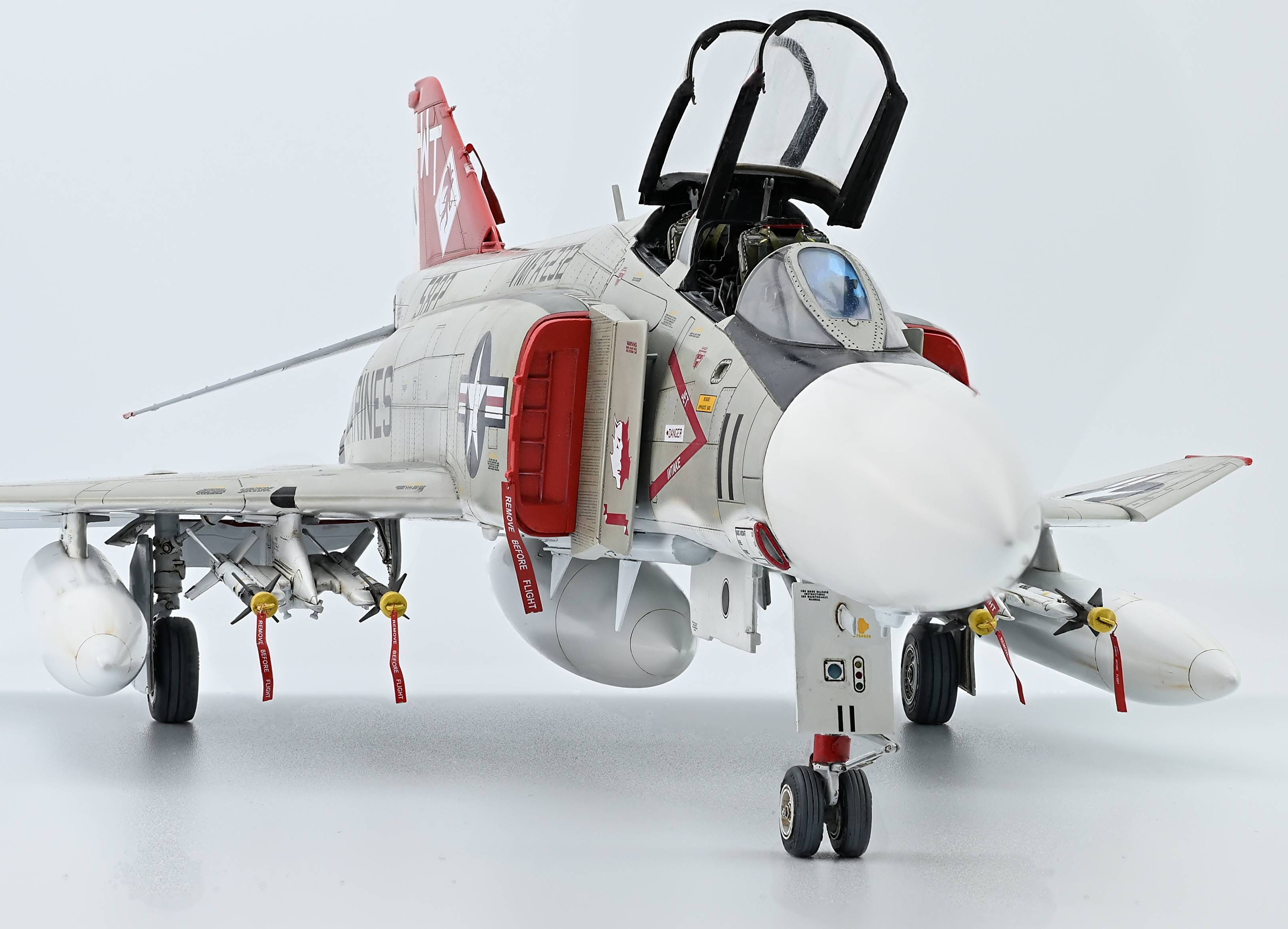

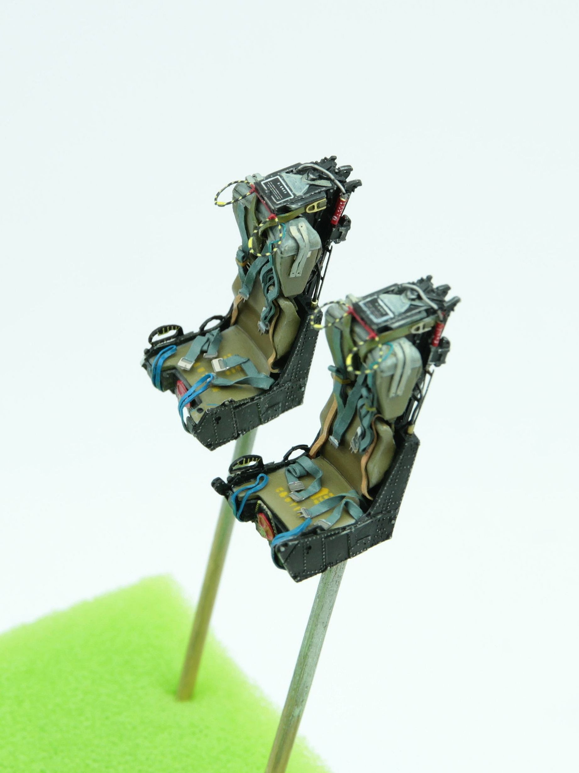

I found one more close up from the other side and few pictures of seats that are inside, I've spend around 25-30 hours on the seats (a lot more than ZM kit deserves)
Absolutely spectacular airplane!  Photography as well.  I have yet to try focus stacking, but your images are a real motivation.  And thank you for posting the seat photos as well...beautiful work, for sure, a standard for me to attempt to attain, though unlikely I could even get close!  In particular, I love the variation in the seat harnesses, not just duplicates of each other, a subtle but important addition to aid realism. Beautiful!
